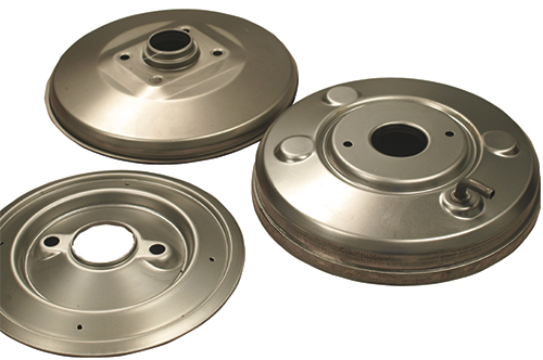

Top: The walking-beam transfer line makes these three brake-booster stampings—front and rear covers, and a diaphragm plate (bottom left). Twenty percent of the front-cover stampings are for turbo engines, and require GLMS to add a weld nut and welded tube to the part (right).

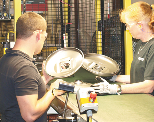

Bottom: At the end of the line, press operator Kristi Pruitt and plant engineer Ben Jones visually inspect stamped parts for burrs and blemishes.
