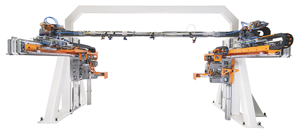

A Space-Saving Transfer Solution
The comprehensive transfer-automation concept combines a blank feeder with a fully automatic tool-change system, the CompactTransfer system, and standard robots at the end of the press line. Programming the motion curves, Strothmann used Siemens press-simulation software to determine the most efficient and safe paths. The theoretical maximum acceleration is 25 m/sec.² for the horizontal axis and 15 m/sec.² for the vertical axis. In operation, the system accelerates by 20 m/sec.² (horizontal axis) and 10 m/sec.² (vertical axis). Retrofitting the CompactTransfer system proved to be a simple and fast process for VW. It was able to exchange a complete module within a few hours by using the existing drill pattern on the press frames. In keeping with the drive for standardization and uncomplicated maintenance, only standard parts were used for the linear-motion bearings and drives. And, as specified by the customer, Strothmann installed Siemens drives for the particularly highly demanding tasks.
In comparison with articulated-arm systems, the solution therefore offers a range of advantages: the linear technology used for carrying out the complex and long transfer paths is simpler and more transparent for the operator; orientation stations are not required; and the drives are positioned where they cannot be destroyed by the dies.
Setup time also has been significantly reduced through automation. Strothmann fitted the die-change tables with front holding frames. Now, whenever the press line needs to be set up for different parts, the Compact-Transfer can simply place the crossbar in the bracket so that it is removed from the press line along with the dies. The operator can then loosen the quick-release skewers on the crossbar and exchange the tooling.
