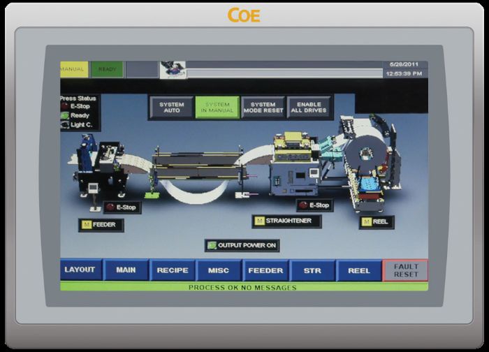

Delivering Detailed Line Data to One HMI
Helping to integrate press-line equipment seamlessly into a unified line, according to Bob Southwell, executive vice president at Aida-America, is its move to implement Allen-Bradley drives and controls from Rockwell Automation. “One press HMI,” says Southwell, “that integrates all of a line’s peripheral equipment—transfer system, coil line, destacker, etc.—helps greatly with maintenance faults, providing detailed information to the line operator in one place.”
