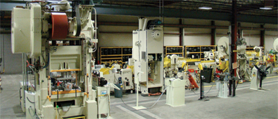

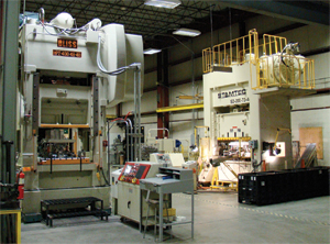

Vogelsangs newest press line
Vogelsang’s newest press line stars a refurbished 400-ton Bliss press along with a new servo feeder and refurbished straightener. It joins a line installed in 2008 anchored by a new 220-ton Stamtec press, also equipped with a new servo feeder as well a refurbished Raster reel-straightener combo and Prab scrap conveyor. The conveyor runs under the press and through an outside wall to a motorized chute and into a hopper.

The 400-ton line joins
Press line inclueds a knurling machine
The 70-ft.-long 400-ton press line includes a knurling machine that profiles the strip coming from the feed line. Two loops even out material flow—one loop lies between the decoilers leading to the straightener and out into the knurling tooling and then into the profiling station, and a second loop lies between the profiling station and the press feeder.
a line installed in 2008 anchored by a brand-new 220-ton Stamtec press, also equipped with a CWP servo feeder as well a refurbished Raster reel-straightener combo and Prab scrap conveyor. The conveyor runs under the press and through an outside wall to a motorized chute and into a hopper. An automatic rotating spreader evenly distributes the scrap throughout the 20-yd. scrap hopper.
