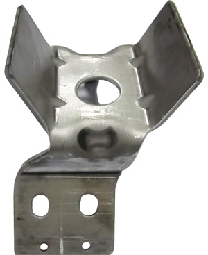

ODM Tool & Manufacturing, McCook, IL, a medium- to heavy-gauge metal-stamping and assembly manufacturer located near Chicago, recently was contracted to design and build tooling to stamp pickup-truck transmission mounts for a Tier 1 rubber-molding company. Finished parts route to a major automotive OEM. During the stamping process, a large portion of each mount is coined to reduce the thickness of the steel to accommodate the rubber molding. The pressure needed to coin the parts exceeded the 1500-ton capacity of ODM’s largest press.

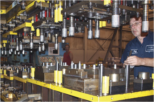

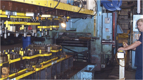

ODM shipped the die for the project to Stamco for its engineering team to review, and ensure that the die would operate properly in Stamco’s 3000-ton press. In 17 days, Stamco was able to adjust its production schedule to set up the die, obtain all necessary materials and steel, and work with ODM engineers on trial runs for PPAP. A final tryout at Stamco, attended by ODM personnel and representatives from the Tier 1 customer, proved successful and the part entered production to meet the OEM’s deadlines.

Working with the OEM customer, the Enterprise management team decided that hard tooling and stamping the suspension-assembly components, rather than continuing with laser cutting and press-brake forming, was the to go. Already familiar with Stamco’s capabilities through previous work, the OEM suggested a partnership between Enterprise and Stamco.
“Enterprise has the welding and assembly expertise and Stamco has the stamping equipment and the knowhow to produce large, complex high-volume stampings,” says Enterprise general manager Chris Weinkamer.
Stamco stamps this part for ODM Tool & Manufacturing, a pickup-truck transmission mount of 5.2-mm-thick high-strength low-alloy steel. A large portion of each mount is coined to reduce thickness of the steel to accommodate rubber molding around the part, to provide vibration dampening. The pressure needed to coin the parts exceeded the 1500-ton capacity of ODM’s largest press.
To convert the laser-cut and press-brake-formed parts over to stamping, teams from Stamco and Enterprise worked to accommodate the idiosyncrasies of stamping. For example, the laser-cut parts had 45-deg. corners and the stampings had rounded corners. That meant taking a design well-suited for laser cutting and making it work as a stamping.
Nine large progressive dies were built at a cost of $750,000, which the OEM covered. For this tooling investment, the OEM realized an annual savings of $1 million. And, because of the increased volumes, the OEM also agreed to purchase mill-quantities of steel, which further reduced its costs. In the end, stamped parts were shipped to Enterprise for welding, assembly and finishing.
