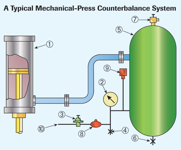

Fig.1—The counterbalance cylinder (1) includes a piston rod that attaches to the press slide and counterbalances the weight of the slide and upper die. Included is a pressure gauge (2) designed specifically for press-vibration duty. An adjustable air regulator (3) on the press permits accurate adjustment to the correct setting.

System Components
Fig. 1 shows the major components that make up a mechanical-press counterbalance system. The counterbalance cylinder (1) includes a piston rod that attaches to the press slide and counterbalances the weight of the slide and upper die. Included is a pressure gauge (2) designed specifically for press-vibration duty. An adjustable air regulator (3) on the press permits accurate adjustment to the correct setting. Bleeding the system occurs quickly by opening the blow-down valve (4).

Many presses have two cylinders for each slide (5). Double-action presses have separate counterbalance systems for each slide.
The check valve (8) prevents a sudden loss of pressure from the counterbalance system in the event of an air-source failure. In addition, the pressure-actuated switch (9) will open the main motor run circuit should the pressure fall below a minimum value specified by the press manufacturer. This ensures that the press will not run without enough air to balance the slide alone.
Note: Never adjust the pressure switch below the required minimum setting specified by the manufacturer, or bypass the switch with a jumper wire. If the correct counterbalance pressure cannot be maintained, erratic press operation may result. Several likely causes include:
