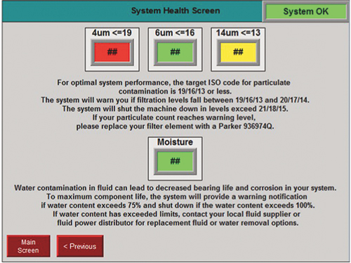

This screenshot of the press’s fluid-health system helps operators understand how fluid contamination can impact press performance. The system provides warnings if fluid health declines past a defined point.
