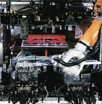

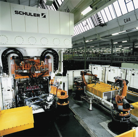

These photos from Schuler showcase a robot-tended hot-stamping line and the feeding of heated blanks into the die.
After exiting the oven, each heated blank transfers to a hydraulic press via robot or pick-and-place mechanism. At this stage the blank has a strange muted glow to it as it settles into the lower die section. The press closes tightly to clamp the die shut at a relatively high tonnage—not so much for the forming process but for the need to create an extremely tight bond between the die surfaces and the part. The die is permeated with channels in its upper and lower sections, designed to distribute cooling water throughout. The tightly closed die functions as a heat sink, absorbing the heat from the part. The blank cools quickly, within seconds, by several hundred degrees until it reaches the martensite phase. This results in a lightweight blank with phenomenal strength characteristics.
Dies open and closed, stationed in an AP&T hot-stamping line. The closed die performs forming and cooling functions.
Cool the blank too slowly and it will enter the bainite, ferrite or pearlite phases and exhibit out-of-spec properties. Conversely, by controlling the cooling process in the die, it is possible to create hot-stamped parts exhibiting various strength characteristics throughout their length. This proves critical in applications requiring a part to crumple in one area while maintaining stiffness in another, such as an automotive safety pillar.
After a few seconds, the die opens and the automation device removes the part from the die and places it on a rack. Blank trimming typically is performed by laser cutting; alternative trimming techniques also are used.
