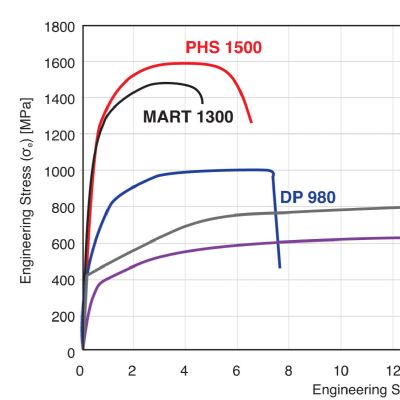

Material evolution represents another example of complex technology. Advancements in steel technology has led to a new class of high-tensile-strength materials called advanced high-strength steel (AHSS). Except for the boron-based hot forming grades, these materials are designed to be cold formed in traditional stamping dies and press lines at room temperature. These materials may exhibit two to three times the tensile strength of traditional high-strength low-alloy steels, placing unprecedented demands on new tooling and older press lines.
A third generation of AHSS materials features tensile strengths approaching those of hot formed stampings but with enough ductility to be cold formed at room temperature. These ultra-high-tensile-strength materials surely will push existing press lines beyond their designed-for capacity limits.
