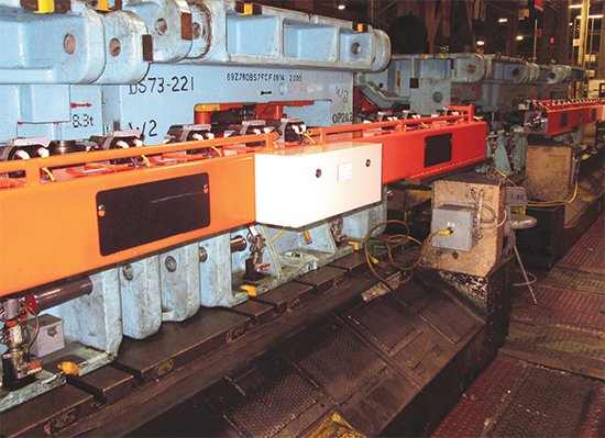

The transfer challenges were such that in 2009, Ford embarked on a replacement program, swapping out the old with new floor-mounted electronic transfer feeds (ETFs). Linear Transfer Automation, Barrie, Ontario, Canada, replaced all five, beginning in 2010, with the latest ETF entering production this past July.
As was the plan, the new transfers have brought greater speed and increased flexibility to the press lines at Ford Flat Rock.
“The new ETFs are offering 35-percent improvement over the mechanical transfer systems,” says Sparkes.

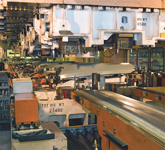

A Mustang fender exits a 2000-ton press at Ford-Flat Rock. The ability to smooth the transfer curve via simultaneous x-, y- and z-motion has upped strokes/min. during Class-A part production. |
Critical to upping transfer speed with the ETFs is the ability to add motion range profiles.
“For example, at Flat Rock, the old transfers performed big, square moves …basic motions,” explains Paul Stirrett, vice president of sales for Linear Transfer Automation. “On one of the lines, the old transfer only could provide 350 mm of lift, and Ford asked for 400 mm. We added that, which proved essential for new dies coming in for Mustang production.”
Such an increase in range assists as Ford adjusts motion profiles.
“Instead of the big, square moves required with the old mechanical transfers, the ETFs can round out curves,” Stirrett says. “With electronic servo-operated movement, we can round out the lift, grip and pitch motions to allow a smoother motion profile when transferring parts, which adds speed.” Sparkes agrees.
“With electronic transfer, we can start to change profiles to increase jobs per minute,” he says. “The mechanical transfers limited us to in-out and up-down motions. With electronics, we can look for transfer shortcuts. For example, as the transfer rises, instead of performing a complete rise before any other movement, it can begin to advance at the same time. We are looking for ways on each job to make the transfer stroke more efficient.
“As it is, electronic transfer is a little faster,” Sparkes continues, “and it takes some of the load off of the press. Where mechanical parts of the transfer had been driven from the same press motors that power everything else, we now can release some of that press energy for use only on the press and at the same time quicken the transfer motion.”
