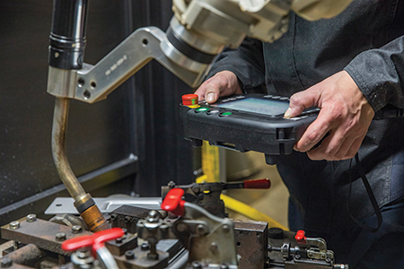

1. Use Proper Weld Settings
Factors such as wire size and material thickness determine proper weld settings. Some welding power sources offer technology that allows welders to input the wire size and material thickness, with the machine suggesting recommended parameters for the application.Without this technology, finding the correct parameters involves trial-and-error. Sometimes the robot manufacturer, welding-power source manufacturer or system integrator can assist in choosing and testing specific materials to provide a starting point for the proper welding parameters.

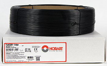

2. Choose the Right Wire
From choosing the right welding wire to establishing a proper tool center point, many variables play a role in optimizing robotic-welding cells to produce the best results. |
While solid wire has been the industry sta-dard in robotic welding for many years, metal-cored wire provides an alternative that offers productivity and quality improvements in some applications, particularly in the manufacture of heavy equipment and automotive exhaust systems, chassis and wheels. However, each wire type offers pros and cons for certain applications.

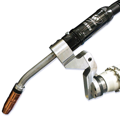

3. Consider the Gun and Consumables
Robotic-welding guns and consumables, including the nozzle, contact tip and gas diffuser, greatly impact performance. The right combination reduces unplanned downtime and improves overall cell efficiency.
Robotic-welding systems, typically operating at higher duty cycles than semiautomatic welding applications, may utilize transfer modes known to be especially harsh on gun consumables. As a result, use of more heat-resistant, heavy-duty consumables, such as chrome zirconium contact tips, or tips designed for pulsed-welding processes.
Verify that the welding gun’s duty-cycle and amperage ratings meet application requirements. To avoid excessive wear and premature failure, the gun should not rub against any part of the system or another robot in multi-robot applications.
Welding consumables, including the nozzle, contact tip and gas diffuser, have a huge impact on performance in the robotic-welding cell. Consider using heavy-duty consumables that are more heat-resistant than standard-duty consumables. |
