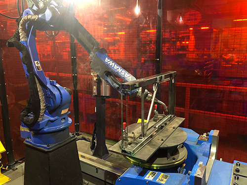

After a thorough process review, and a design and building phase, Freedman Seating implemented a custom robotic-welding workcell for the manufacture of foldaway seat frames.
The solution featured a Yaskawa Motoman robot on a fabricated steel riser and an MA2010 extended-reach welding robot with through-the-arm torch cabling and a Miller Electric Continuum 350 metal-inert-gas weld package. The robot also features a ComArc seam-tracking package with 200V high-speed touch sensing function, suitable for tracking stainless-steel lap joints from 3-mm thick or more. This function assists in compensating for weld-joint location variance, helping the system produce precise, clean welds.
The custom tilt-rotate positioner combines a standard turntable base with framework to hold two MotoPos D500 tilt-rotate positioners on each side. Each servo-driven MotoPos D500 two-axis positioner has a 500-kg payload capacity with ±0.1-mm repetitive accuracy. Each can rotate ±370 deg. and tilt ±135 deg., enabling the continual welding of seat joints from 1⁄16 to 1⁄8 in. thick in continuous motion.
Coordinated motion software used in the robot controller ensures synchronized motion between the robot and positioners, with the robot and positioner axes moving in unison at an interpolated constant speed, allowing the torch to maintain optimum posture while the workpiece turns. This cohesion provides the ability to complete each safety critical weld in position—unlike the prior fabricating method—providing consistency in weld quality by always placing welds in the same location with programmed weld parameters.
