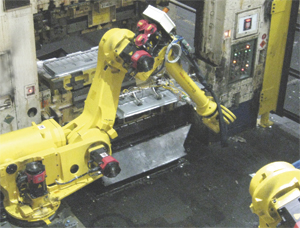

Ford replaced the straight-path automation on Line 8 with Fanuc R-2000iB/100P six-axis robots located between presses, along with Fanuc and R-J3iC controllers. The difference?
“Now we produce up to 550 to 575 parts/hr.,” says Dively, “and do so reliably. Quality is improved because the robots better locate parts on the dies.”
Also, diesetting has improved on a similar scale.
“One switch locks all of the robots, and we go in and replace the robot tooling arms, then command the robots to ‘go to dieset,’ where they position themselves out of the for die change, then we hit startup for the next job,” Dively explains. “That is much quicker and easier than with the old straight-path automation.”
On Line 8’s entry end, a robot loads the press with mild-steel blanks, 0.031 to 0.040 in. thick, from a manually stacked tray. After forming, the stamped doors, dash panels and reinforcement bars, primarily for F-150s and Explorers, are gathered, aided by an air-clutch-driven exit conveyor and automation that enables limited stacking prior to manual handling and rack storage.
“We may be able to stack four parts and then index for a couple of seconds, so the worker at the end of the line is not overwhelmed with parts rolling at him,” says Dively. “He receives a stack of parts and racks them, and by the time he turns around he has another stack of parts waiting.”
