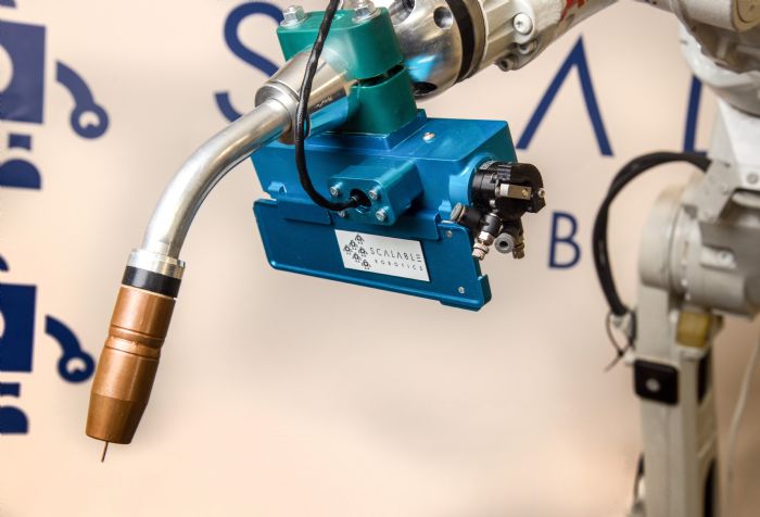

ABB-Scalable-Arc-robotic-welding-programmingAlso on display, the Scalable Arc platform, technology that enhances ABB’s existing portfolio of no-code programming applications designed to help remove the need for specialized programming knowledge. The platform allows a welder to teach a task to the robot by pointing to where the weld should be applied, with the robot learning the path on its own. The platform features a 3D camera in a protective box attached to the robot end-of-arm tooling, and uses a touchscreen interface to guide the welder through the scan, teach, validate and tuning steps.  At FABTECH, Scalable Arc was featured on the FlexArc U2 robotic welding cell.
