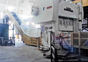

Press lines are interlocked to a main scrap conveyor
In many metalforming facilities, press lines are interlocked to a main scrap conveyor, and if that main conveyor goes down the press lines automatically shut down as well.
