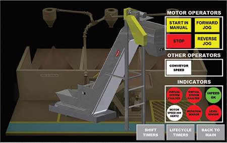

This screen allows a technician to review and perform specific functions on a piece of equipment. The “Indicators” section is designed to be like a dashboard, enabling the user to quickly identify the conditional states of componentry related to the specific piece of equipment.

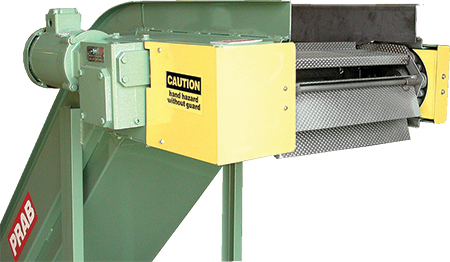

Anspaugh: First, many types are available. Steel-belt conveyors find use for any wet or dry metal stamping scrap: bushy material, die cast scrap, metal chips and turnings. Pivot belt conveyors handle small, sticky thin-gauge lamination scrap. Screw conveyors handle wet or dry flowable chips or turnings. Drag conveyors move abrasive scrap: wet or dry metal chips, fines and swarf. Oscillating conveyors handle stamping scrap, finished parts, die-cast scrap and any hot, dry or wet scrap. Pneumatic conveyors are ideal for wet or dry chips. Prab’s ScrapVeyor eliminates carryover of wet or dry stamping scrap.

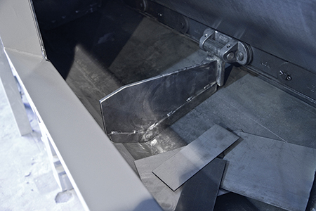

Anspaugh: A lot has to do with scrap size and volume. For example, steel-belt conveyors move a high volume of scrap and are considered the workhorses of the industry, but some scrap types can cause carryover issues. Carryover, scrap caught in the belt that does not discharge, causes maintenance issues. Our ScrapVeyor, for example, with its trough design, offers a better alternative when it comes to carryover. Having the right conveyor is important as conveyors function as the lifeline for manufacturing stamping plants striving to avoid costly downtime.

West: Our smart-programming concepts provide maintenance-schedule alerts, and diagnostic-fault programming makes corrections without human intervention. For faults requiring manual correction, we provide a one-screen-control approach that walks the customer through the fault for quick resolution. We also offer email/text notifications for system conditions that the customer would like to monitor.
West: Instead of crowding the screen with commands and control features not needed by everyone, our one-screen-control approach provides tailored screens with specific information required for operators, mechanics and supervisors. We’ve also assembled a 10-person IIoT team and are working with a German software company, Cumilocity, on facilitating the collection of cloud preventive-data points—amp draws, run time, human interface (someone pushed a start/stop button), etc. We’re close to introducing this. (Editor’s note: At presstime, the date was set for the end of February.)

The offset-trough design on this conveyor eliminates scrap carryover.

Pivot-belt conveyors with a rigidized belt surface prevent scrap from sticking. Pivoting hinges flip scrap into the hopper.
