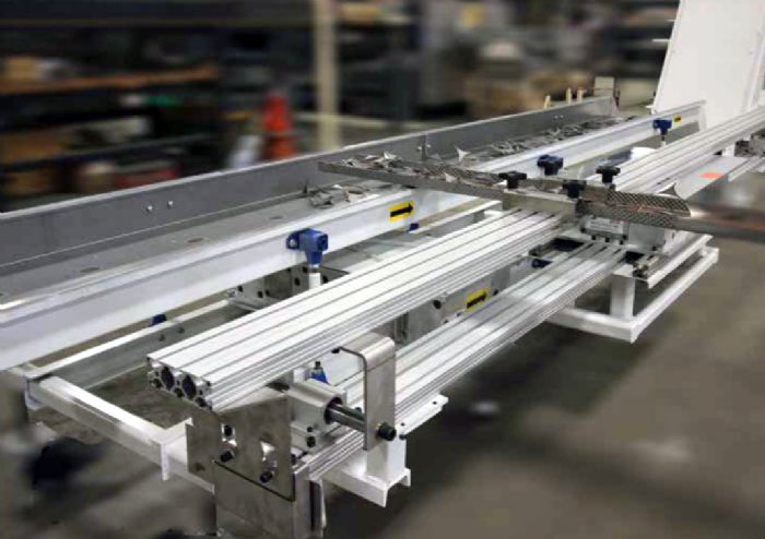

Fortunately, solutions exist for operations that exhibit these red flags. Modular, quick-connect conveyor components and systems provide optimal options for metal formers, Rhodes reports.
“Look for modular designs that allow operators to move equipment by hand without damaging the equipment or hurting themselves, and without the need for forklifts,” he says, noting that such designs may feature casters for eased movement around on the shop floor, along with the use of common components and the ability to link scrap-system components together as needed.
Also, newer, more reliable scrap- and part-handling technology has yielded systems that last much longer and require less maintenance. And, Rhodes explains, should maintenance be required, fixes come more quickly and easily.
“For example, a metal former’s conveying equipment couldn’t remove scrap as quickly as the 2500-ton press produced it, and scrap was backing up in the die,” he says. “Now, press-mounted electric shakers along with steel pans that go between the press uprights shake the scrap out onto a 20-ft.-long, 24-in.-wide conveyor. Linear shaker systems represent a big trend in scrap handling. The solid steel pans hold up much better than steel belts, and these linear shaker systems require much less maintenance. We use shakers wherever we can due to their reliability. And, this modular setup uses four modular motors for four shakers, with eight motors for eight shakers when it’s fully installed. Again, any scrap-handling components on the floor have casters, with pins and clamps providing for quick connect and disconnect on the press and with other components.
“Perhaps 10 years down the road when something in this system goes down or if a forklift hits it or whatever, because this system is modular, the metal former simply grabs a motor off the shelf, unbolts the failed motor and bolts on the new one,” Rhodes continues. “The scrap-handling system is back online in as little as 20 min. Previously, should a steel-belt conveyor go down, the metal former had to pull it aside, manually remove the scrap, wait for maintenance to fix it or call the manufacturer to get spare parts. Modular systems are a game-changer in terms of uptime and how we think about return on investment (ROI) for scrap-handling systems.”
Also, during job changeover, modular conveyor components simply roll out of the way by hand—no forklift required.
This same example cited by Rhodes offers another conveyor innovation.
“This metal stamper also experienced damaged and dented parts due to stamped parts dropping onto an old part-out conveyor,” he explains. “Different dies drop out parts from different heights, so a new conveyor of maintenance-free design—as compared to the conventional rubber-polyurethane tension belt it replaces—will index up and down to minimize the drop height.”
