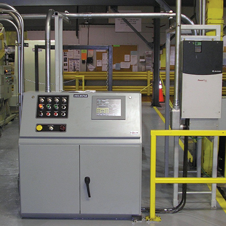

HelmPak press controls from Helm Instrument Co. can be configured for applications ranging from simple clutch/brake control to transfer line control. Given the open architecture of a PLC system, the company’s engineers can design and build controls requiring less operator involvement and enabling an array of automatic setup procedures while providing feedback information for production analysis and reporting, according to company officials. System capabilities include redundant clutch/brake control as well as main-motor, lubrication and transfer control. In addition, the HelmPak provides tonnage monitoring, brake and die monitoring, signature analysis, and shut-height and counterbalance control. Other features: servo-feed interface, Ethernet connectivity, and expandable I/O configurations for integrating auxiliary machine control. System configuration begins with standard Allen-Bradley processors and I/O modules for basic functionality, with automation added via Helm specialty I/O modules for various platforms. Interactive touchscreens enable simplified setup and operation.

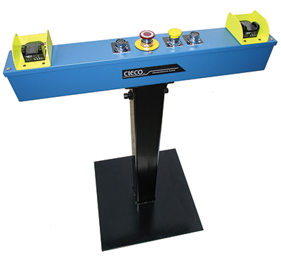

For use wherever ergonomic touch buttons would be deployed, or to replace mechanical buttons, Cieco offers its Saf-T-Touch ergonomic safety touch buttons. The buttons, operational with gloved hands, reduce the chances of carpel tunnel syndrome and fatigue in repetitive operations via ergonomic no-force actuation. Diverse dual-sensing technology prevents inadvertent actuation from false triggering sources, and redundant processors with dual monitored outputs provide control-reliable operation. For trouble-free performance, the buttons feature electromagnetic compatibility, meaning superior noise immunity from external radiated and conducted noise, according to company officials.
Installation is simple, with industry-standard 30.5-mm-hole mounting and pluggable terminals to simplify wiring. Indicators provide for simple troubleshooting and output status, and solid-state terminals eliminate the need to replace buttons due to worn relays.
