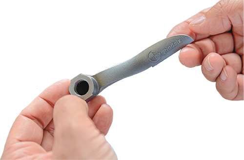

Coolant nozzles by Grindaix
Coolant nozzles by Grindaix feature gentle curves made possible by 3D printing.

The new nozzle demonstrates efficiency in many ways. Optimizing the flow of coolant reduces pressure losses by as much as 20 percent, meaning that lower pressure and less energy achieves the specified coolant-exit velocity. Curved channels and optimized jet trajectory deliver the coolant precisely where needed, delivering no more and no less than is required to carry out the process in an optimum manner without causing thermal damage. This reliable and automated solution for delivering coolant eliminates factors that may have previously caused hold-ups in the manufacturing process.

While pleased with the new nozzle, Friedrich does not conceal drawbacks associated with 3D printing. “Sintered parts have a rougher surface than those made from conventional metals. On the outside, at least in our case, we can correct this issue through polishing. To eliminate the roughness on the inside surfaces, which would once again lead to flow losses, we pump an abrasive fluid through the coolant nozzle at high pressure.” To achieve a tight seal, a separate process corrects the connecting thread’s roughness.
