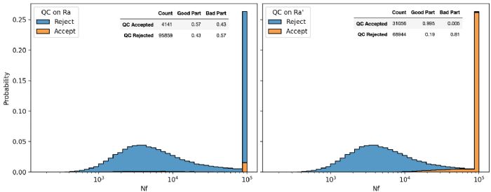

3-EWI-predicted-fatigue-lifeAs a second use case of the forward model, we consider the selection of a quality-control plan. Here, we compare two plans designed to ensure a minimum fatigue life of 10,000 cycles at 1-percent maximum strain. In the first strategy, we inspect the as-built samples. This plan can reduce costs by rejecting parts before surface finishing. In the second plan, we inspect the parts in the surface-finished state. Fig. 3 shows two histograms comparing the predicted fatigue life at 1-percent maximum stress for a component finished via the REM ISF process with a 30-micron layer thickness, a 90-deg. surface angle and all other input variables unconstrained.
The first strategy (Fig. 3, left) cannot achieve a useful decision threshold. The 15-micron threshold used to generate the figure produced a 43-percent false-positive rate. Decreasing the threshold further reduces the already low count of accepted parts. This strategy cannot overcome the variability introduced by the surface-finishing process.
The second strategy (Fig. 3, right) provides much better results. Using a roughness threshold of 2.4 microns limits the false-positive rate to 0.5 percent while maintaining a limited false-negative rate.
To further validate this quality-control strategy and link to probability-of-detection concepts, this model can be extended to include the measurement error.
In a hybrid approach, roughness measured in the as-built state could be used to select the most cost-effective surface-finishing approach within predictive performance requirements, with roughness then confirmed in the surface-finished state.
