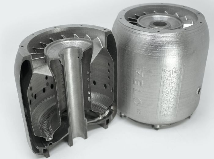

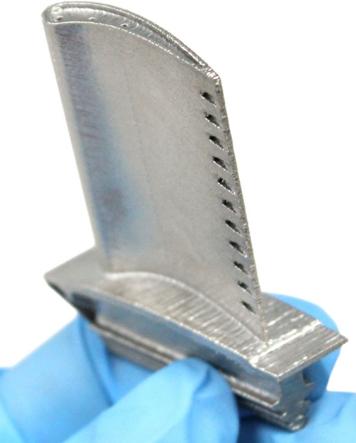

Velo-3D-Superalloys-Turbine-Blade-Hastelloy-XGiven the desirable qualities achievable with superalloys, companies beginning to explore the potential of AM are asking for equipment—or access to contract manufacturers running advanced industrial AM systems—that can handle such material.
