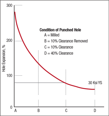

Fig. 2—This hole-expansion study documents the tremendous reduction in edge stretchability for punched holes. R.R. HilsonMicroalloying 75.

4) Some metalforming professionals complain that the FLC is flawed, because the actual measured edge stretch before fracture is much less than predicted by the FLC. However, the real problem lies with improper application of the FLC, never intended as a tool for predicting the allowable stretch in sheared edges. The height of the FLC depends on the n-value and thickness of the as-received sheetmetal. Cold working the blank via cutting, shearing or punching greatly reduces the n-value of the edge, and the FLC. Fig. 2 shows a relatively undamaged milled edge with a hole-expansion ratio of 280 percent, and a traditional punched hole with a hole-expansion ratio of only 80 percent. The severe reduction in hole-expansion ratios can be even more severe for AHSS DP and TRIP steels, because the islands of martensite at the cut edge can initiate earlier fractures. MF
