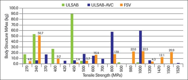

Fig. 4—With the advent of the FSV project, we’re well on our to use of AHSS grades in excess of 1500-MPA tensile strength.

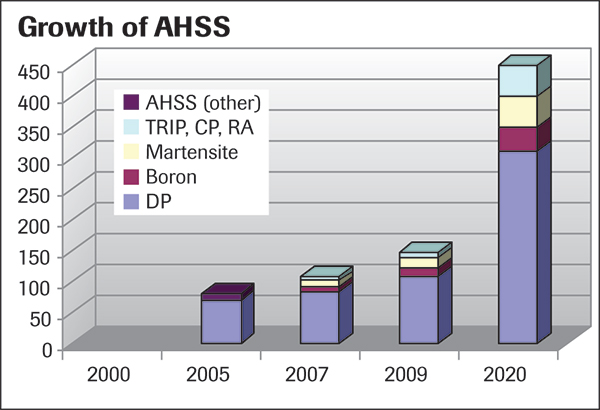

Simultaneously, from 1990 to 2010 the influence of regulations governing vehicle crashworthiness increased dramatically. The National High Traffic Safety Administration (NHTSA) and the Insurance Institute for High Safety introduced more crash tests during this time than during any other period in history (Fig. 1). These regulations stimulated, from 2000 to 2010, the rapid adoption of AHSS grades into vehicles (Fig. 2). These materials became the proven choice for passing new crash tests and avoiding excessive weight gain.

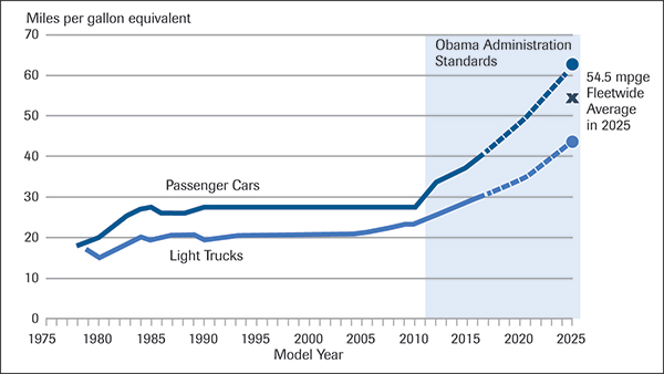

Further need for development of higher-strength steels came from NHTSA and the Environmental Production Agency with the new wave of CAFE fuel-economy regulations, to be implemented from 2012 through 2025 (Fig. 3). Now, in addition to safety, AHSS grades need to contribute to mass reduction so that car companies can improve corporate fleet fuel-economy by about four percent per year until 2025.
An important global steel industry project, FutureSteelVehicle (FSV), was completed in May 2011 with considerable engineering optimization technology leading to results building on the success of the ULSAB-AVC project. In FSV, optimized steel designs were applied to the latest electrified powertrain vehicles, battery electric vehicles, plug-ins and fuel-cell cars. Every aspect of ULSAB-AVC technology is enhanced in FSV, and there is a noticeable shift to higher tensile-strength steels (Fig. 4). The AHSS grades are considerably stronger and more formable—five different grades of AHSS exceed the 1000-MPa level.

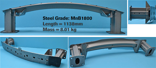

Today we see the trend of introducing steel grades with increased tensile strength continuing. For example, an 1800-MPa tensile-strength bumper recently was developed for the Mazda CX-5 bumper (Fig. 5). This represents the highest production tensile-strength automotive part to date. Tensile strengths exceeding 2000 MPa are familiar in parts like aircraft landing gear, but not automobiles. While the processes used to make aircraft parts, such as vacuum arc remelting and forging, are not typical automotive processes, automotive steels are indeed approaching that amazing 2000-MPa threshold.
Fig. 5—This 2014 Mazda CX-5 bumper assembly features a hot-stamped beam of 1800-MPa steel.
