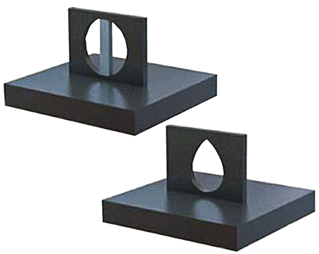

The metal-AM process designer must carefully consider and plan for the quantity and weight of the support structures. Supports in holes can improve the roundness and microstructure in downfacing overhangs. The top image represents poor support-design practice; the bottom is optimal. If the hole has an angled or arched upper area, it likely will not require any supports.
In preparing for production, several factors affect how to orient the part in the build chamber, including cost, quality, buildability, and post-processing needs and capabilities. In terms of buildability, instances occur in metal that require support structures to build a part. For example, shallow angles of 5 to 10 deg. require support structures.
To ensure quality, consider the quantity and weight of the support structures used. Often, when manufacturers try to additively manufacture legacy parts, they will be oriented at an angle that requires heavy support structures. These AM parts will require additional post-processing to achieve good surface quality. And, when considering cost, carefully balance how many parts can be built at once on the platform without significantly increasing build time.
