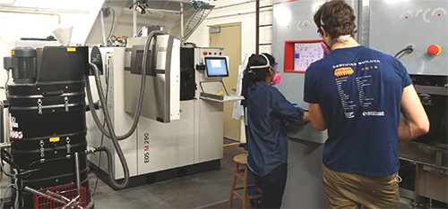

The NextManufacturing Center facility is home to two Arcam S12 electron-beam metal-printing machines, an EOS M290 laser-sintering metal machine and an ExOne Innovent binder-jetting machine. Also in the lab are polymer printers (Objet and Stratasys models) and finishing equipment, including a GF Machining Solutions wire-EDM machine. |

We saw evidence of this development work during our tour of the NextManufacturing Center, home to two Arcam S12 electron-beam metal-printing machines, an EOS M 290 laser-sintering metal machine and an ExOne Innovent binder-jetting machine. Also in the lab are polymer printers (Objet and Stratasys models) and finishing equipment, including a GF Machining Solutions wire-EDM machine. In particular, CMU mechanical-engineering Ph.D.-candidate student Zack Francis explained to us the impact of beam-spot size, power and speed on the melt pool and on part quality. Also noted: how high-speed imaging can be used to better understand what goes on during the build.
Most recently, CMU mechanical-engineering Ph.D. student Sneha Narra explained, researchers have begun to understand how to vary process parameters at different locations in the build to customize material characteristics—more ductile in one area of a part, for example, and harder or more impact-resistant in another area. And, fellow mechanical-engineering Ph.D. student Colt Montgomery is looking closely at a fairly common concern regarding 3D metal printing: the challenges of printing overhanging features. A key variable here: being able to change beam-spot size during the build, which gives the user more flexibility with power and velocity. (The students note that not every 3D metal-printing machine offers this capability.)
