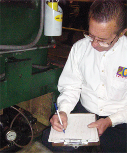

The 5S workshops introduced visual factory methods at Talan Products. For example, operators were expected to record oil pressures each hour. In doing so, many stated that the gauges were too small and were located such that they were hard to read. As a result of 5S, the firm invested in larger gauges that were relocated so that they became easier to see and read. Operator compliance with the task of recording hourly pressures increased.

Talan’s Gene Sawyer takes an hourly reading from a press’s oil-pressure gauge. As part of the firm’s directive to implement a “visual factory,” it replaced its previous gauges with larger gauges, and repositioned them to allow easier and more accurate readings.
