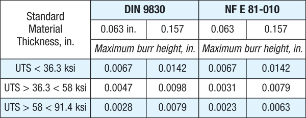

I am familiar with two standards that recommend and specify engineered clearances: DIN 9830 (a German standard) and NF E81-010 (a French standard). Both classify acceptable burr heights relative to workpiece material thickness and tensile strength. The accompanying table provides maximum burr-height specifications from each standard for a precision punched hole in 0.063-in.- and 0.157-in.-thick material. Note that the maximum burr allowance for 0.063-in. material with a tensile strength less than 36.3 ksi is 0.0067 in., following the 10-percent rule of thumb. However, as material tensile strength increases to 90 ksi, the maximum allowable burr is 0.0023 to 0.0028 in.
When material thickness increases to 0.157 in., allowable burr height for the 36-ksi and 90-ksi materials is 0.142 in., and 0.0063 to 0.0079 in., respectively. In this case, both scenarios are less than the 10-percent rule of thumb.
