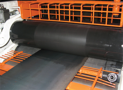

Roll coaters work on a variety of substrates, including stainless steel, and can adjust for material and coating thickness. |
A roll-coating machine can reside in the press line or off to the side. When applying a wet lubricant, the stamper typically would place the roll coater immediately in front of the press with coil or sheet feeding through the roll coater and onward through the forming operation. In dry-lubricant applications, the roll coater typically locates offline, perhaps in a nearby corner where personnel run sheet or coil through and stack it nearby. Then the coil or pallet of prelubed sheets is picked up and transported to the press for stamping.
Roll-coating machines most likely incorporate their own lube reservoirs, with several methods available for lube to be supplied to the machines. Some roll coaters incorporate a 10,000-gal. tank, 55-gal. drum or 250-gal. tote, depending on lube needs. And the machines can automatically request more lube from lube-storage tanks via sensors and controllers on the roll coaters or incorporated into press controls. That means no downtime for lube replacement.
Lube can be reclaimed as well, as some stampers create a fountain where lube pumps into a reservoir on top of the coater, and as the lube is used, excess is captured and pumped back into the reservoir.
