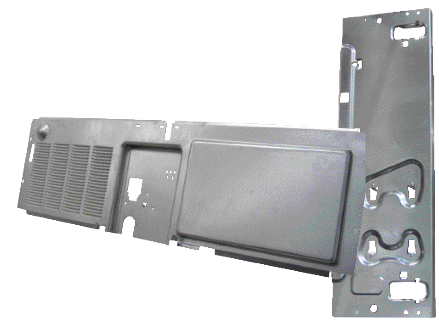

Whirlpool uses the new vanishing oil in presses up to 800 tons on progressive dies running hot-rolled steel as thick 0.090 in., electrogalvanized steel 0.015 to 0.045 in., and 0.035-in. aluminum. Some of the parts are flat-stacked wet, requiring good corrosion protection from the lubricant.
