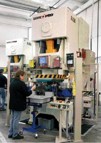

Metalstamp added this ServoPro-equipped 200-ton straightside press
To take on progressive-die applications, Metalstamp added this ServoPro-equipped 200-ton straightside press. “With our conventional straightside presses, in-die assembly sometimes required our operators to stop a press to work on a tool,” says toolmaker and maintenance supervisor Terry Brown. “Each stop took minutes, but with the new presses, operators can perform the necessary tasks in seconds.”
