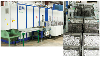

The solution for Thomas Erie: a Dürr Ecoclean Universal 71C solvent-based parts-cleaning system, which uses nonhalogenated hydrocarbons as cleaning media. This setup allows the safe and economical use of solvents for removing oils, greases, emulsions and swarf between or after manufacturing processes. Thanks to its many different process variants using hot or cold immersion with downline vapor degreasing, Thomas Erie’s new parts-cleaning machine has proven ideal for meeting its requirements related to quality and functionality.
The new cleaning system boasts dual work chambers for increased capacity and an automatic feed option that the company can integrate later when it installs a planned conveyor system to further automate cleaning operations. The workpiece baskets at Thomas Erie feed automatically into the first work chamber available, simplifying and streamlining operations.
According to Morphy, the Dürr Ecoclean Universal 71C has provided Thomas Erie the flexibility and consistency it sought, including handling the “semi-clean” specification. The machine’s intuitive control panel makes it easy for the operator to program any number of diverse cleaning cycles, so that, says Morphy, “changing processes takes just a few seconds and a few taps on the touchscreen.
Stamped aluminum components sent through the dual work chambers
Thomas Erie sends millions of stamped aluminum components, such as these aerosol-can closures, through the dual work chambers of its new parts-cleaning system.
And, adds Morphy, the machine provides consistent cleaning results throughout the workday. “We didn’t expect such a high level of consistency. We expected some degradation in the cleaning operation, but that has not been the case.”
