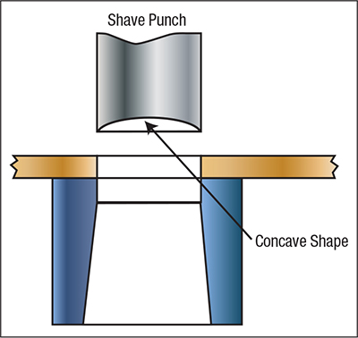

Fig. 2
Shaving thick materials with pronounced die break or taper may require more than one shaving operation. When two shave steps are required, the amount of material shaved in the second step should be one-half that of the first step. For example, if the requirement calls for shaving a total of 0.027 in., remove 0.018 in. with the first shave punch, then 0.009 in. with the second.
Because a shaving operation acts on the sheetmetal more like a machining operation (cutting) than a punching operation, consider adding a rake angle to the shave-punch face (Fig. 2) to facilitate this cutting action. Establishing the proper back-rake angle for each shave application, somewhat of a black art, requires trial-and-error development. Some brass and bronze alloys do not require any back angle at all. Mild steels, depending on hardness, may require 10 deg. or more. And some aluminum alloys have required as much as 45 deg.
