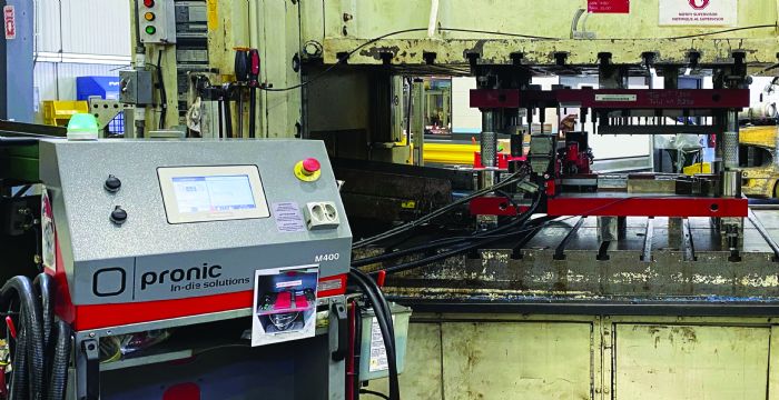

Servo-driven tap units do require a controller to control tap functions and monitor tap torque, and the controller can be reused or shared. And, the controller user interface can store multiple tap programs for different dies.
“The servo-driven single-tap units can be shared or reused for different programs,” Falkenberry says. “Jobs that require a different tap size may require new tap heads and unit gear changes to achieve proper tap-thread-forming speed.”

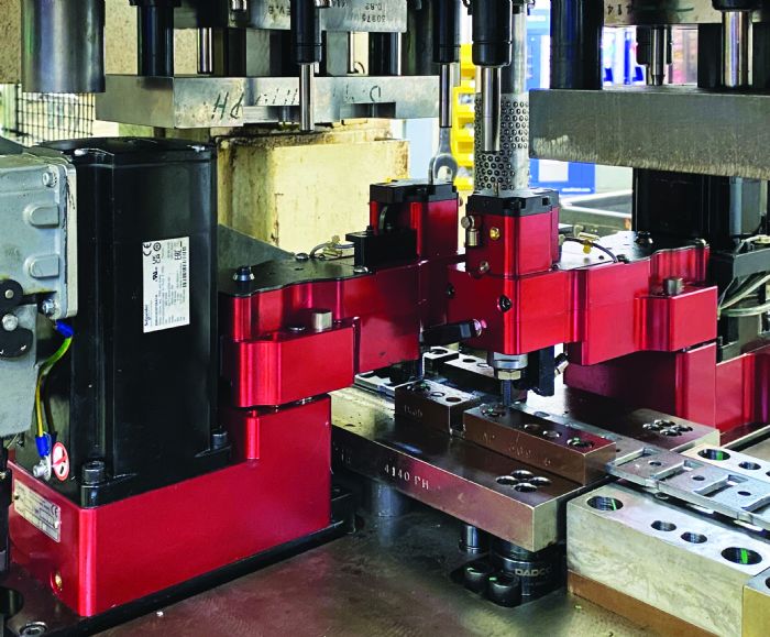

The servo-driven units have proven to be a great asset for GSM, according to Nozykowski, “as we can use them in multiple dies. Prior to this investment, we used old mechanical units with spiral drive screws that pushed taps into the steel as a progressive die came together. Spare parts for these units were hard to come by and became more expensive, with long lead times as well.
“The new servo-driven tapping units, though requiring a greater investment upfront, use much less die space and are much easier to work with, while significantly increasing productivity,” he continues. “If we ran at 8 strokes/min. with the old mechanical units, we reached 20 strokes/min. with the servo-driven units. Production basically doubled.”
The mechanical nature of the old tapping units, and their drive screws, caused issues now solved by the servo-driven units.
“Perhaps we had a shut height of 30 in. to compensate for the drive screw that had to pass through the die set, and the die didn’t have much room available without the screw hitting the press bed,” says Nozykowski. “Now, with servo motors contained in the units to provide tapping drive, we can reduce that 30-in. shut height to 18-20 in.”
Servo-driven systems allow control of the tap travel speeds, according to Pronic’s Falkenberry, thus maximizing the life of the tap.
The lower shut height certainly pays off in added strokes during the course of GSM’s typical 1000-20,000-part job runs. The servo-driven units also pay off in other ways.
“If we want a different-sized tapped hole, we only need to purchase another tapping head and switch the head out while the unit stays within the die—everything else stays the same,” Nozykowski says. “This ability, where we only pay for a new head instead of an entirely new unit, keeps us competitive against others who would have to purchase entire units. And, instead of buying a whole new unit to outfit another die, we buy a set of gibs and a shot pin, pull the unit out of one die, slide it into the gibs on the other die, replace the shot pin, hook up the electrical and cooling, and it is ready to go. It’s a quick change that we could not perform with the old mechanical tapping units.”

The ability to program the servo-driven units provides yet another advantage for GSM, Nozykowski reports.
“With the mechanical units, we relied on the press ram for tapping,” he says. “Now, we simply key in the shut height, required tap travel and material thickness—we’ve been using these units to tap 0.25-in.-thick A572 Grade 50 steel stock—into the unit control panel, and it’s all set for the job.”
The servo-driven in-die tapping units also provide memory for multiple jobs, further easing job changeovers and introduction of tapping units into other dies.

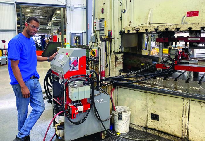

As for maintaining the servo-driven units, beyond general cleaning there’s not much.
“We run about 1 million parts/yr. on the die with the two units without any other tap-unit maintenance besides cleaning,” Nozykowski says. “Maintenance has not been an issue.” MF
