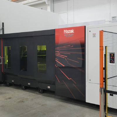

Brand cites the 7-kW OptiPlex Nexus Fiber S7 2D laser cutting machine as one of Co-Line's most impressive purchases—in 2018—from Mazak Optonics, and evaluates the machine as having a considerable impact on Co-Line’s business.
“Compared with our CO2 laser cutting machine, the piece timing has been reduced by approximately one-sixth,” Brand says of its performance on steel approaching 1 in. thick, and impressed with the beam-shaping and diameter-control technology introduced on the S7, along with its intuitive operation. “It’s a tool that everyone should have, like a Swiss Army Knife.”
As to ease of use, Brand reports that he was able to cut parts on the S7 without training—only from what he knew from running prior Mazak machines. Machine dependability also rates high with Brand. As Co-Line measures beam-on time each day, the S7 machine has run consistently in the mid-90s percentile with beam-on auto cycle operations since a month after install, Brand reports.
Besides the S7’s significant impact on Co-Line’s productivity and capabilities, the two 10-kW OptiPlex 4020 Fiber III 2D laser cutting machines also operating on the manufacturer’s shop floor deliver improved ability to cut thicker materials with nitrogen and improved processing times as compared to oxygen cutting. These attributes boost throughput, cut costs and allow greater business opportunities, according to Brand.
