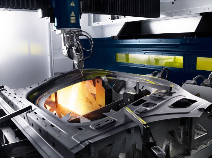

Cutting-Trumpf-laser-Door-TruLaser-Cell-8030“Now, especially at the beginning of this major electrification effort, comes a need for lower volumes, maybe 50,000 or less, and a mix of those parts,” Davis says. “This makes equipment and process flexibility a must. A process designed around rigid stamping tools in this scenario becomes time-consuming and less cost-effective.”

“A large cast-aluminum structure makes up a portion of the body designs in some platforms from one automaker,” he says. “This represents a totally new approach, and these designs require laser cutting or trimming, and then welding. Then the inverters and some big-module electrical components that make up the brains of battery systems are assembled, with bolts or laser welding for the covers to encase the whole system. Laser welding provides a good approach here, as it hermetically seals the structure.”
