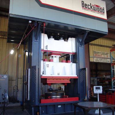

April 1, 2015Beckwood Press Co., St. Louis, MO, recently built and installed a new Triform deep-draw sheet hydroforming press for New Jersey-based Kreisler Manufacturing Corp. Kreisler, a global engineering and manufacturing services provider, caters to the aerospace, military and industrial sectors. The 16-10-7BD Triform (a line specifically developed for aerospace applications) delivered by Beckwood features a 16-in.-dia. forming area, 10,000-psi forming pressure and a 7-in.-draw-depth capacity to facilitate Kreisler’s production of high-performance aircraft and aerospace engine parts.
The inhouse forming capability Kreisler has gained with the addition of the Triform press is part of a larger company expansion, which includes a new manufacturing facility, and the increased use of inhouse 3D printing for the production of sheet hydroforming tools and more.
