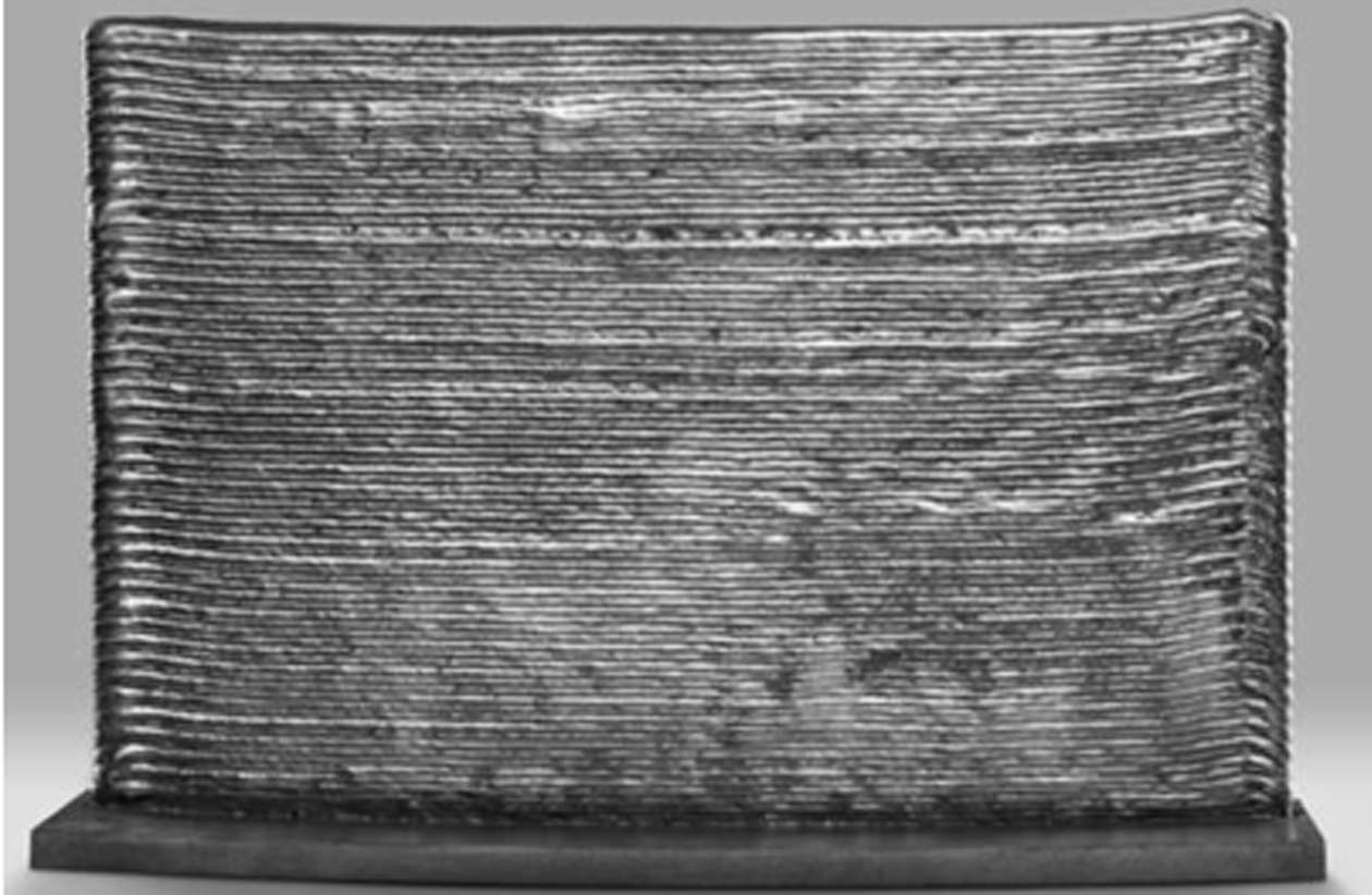

Fig. 2—A distorted wall fabricated using wire-arc DED.

Robotic-arm speed/gantry-head speed, wire-feed rate, nominal thermal conditions, wall structure and the average layer height represent the basic building blocks of printing arbitrary shapes using wire DED. Most components will have relatively simple geometries, but geometrical accuracy might not be as high as with other AM technologies, such as with powder-bed fusion, since wire DED uses an extremely high-temperature heat source. The relatively high heat input can cause high residual stress and distortion (Fig. 2) and negatively affect geometrical accuracy through plastic deformation. It also can dramatically affect the mechanical properties and performance of the printed components, including reduced fatigue life and tensile strength.
