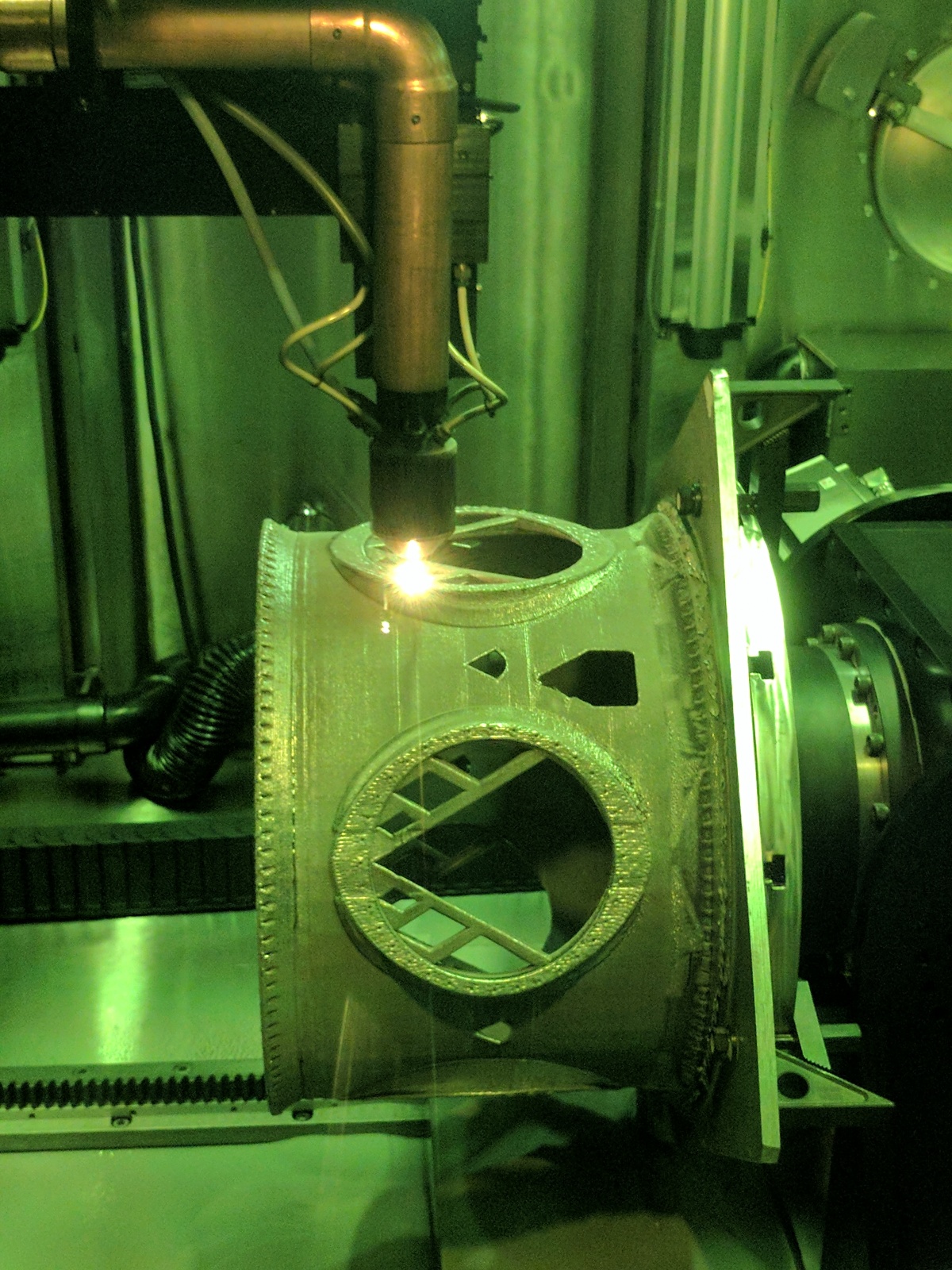

Rotating the part under a laser-powder DED feed head avoids the need to add support material during the metal-AM process.
During the laser-powder DED process, metal powder feeds through tubes for injection into the focused beam of a high-power laser. The DED head mounts onto a gantry or robot, which then moves around the build area to deposit layers of molten metal. The technology has the unique advantage of not requiring an actual bed of powder; it only needs powder in the spray area of the build. Most of the material ends up in the final part, with typically less than 20-percent overspray during builds.
Without requiring a powder bed, DED technology is readily scalable, as most machines can produce parts several cubic feet in size, compared to the typical L-PBF work envelope of less than 1 ft.3. In addition, the DED process does not require support material. By rotating the part relative to the deposition head, many designs that typically would require support material with a powder-bed process can be built vertically without additional support structures.
