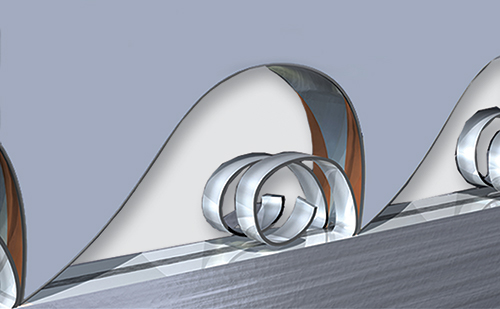

Bimetal saw blades, with steel wire added to backing material, offer a means to extend blade life. Here’s a depiction of a bimetal blade in action, with a patented process enabling backing material to wear away upon first cut to expose extra cutting edges on the blade teeth. |

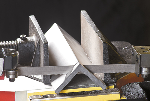

“The small tool and die shops or smaller fabrication job shops with mixed products typically cut a wide range of materials,” he says, “everything from structural materials to sheet metals to solids, and from soft to hard. Multipurpose blades may make the most sense―not perfect for any one application—but good for all of them.”

Bimetal blades offer an option for longer life and for use in a variety of cutting applications, with steel backing providing blade rigidity. One example of a more recent bimetal-blade development offered by Gordon: Starrett’s Bi-Metal Unique blades. This technology joins two strips of high-speed steel wire to the backing steel using solid-state diffusion bonding as opposed to conventional construction employing electron beam or laser welding to join the wire. Here, the wires essentially are fitted into grooves within the backing material. A larger weld-contact area—170 percent more than with conventional methods—reduces fracture at the steel-wire/backing-material interface, according to Starrett officials. Upon initial use, the backing material wears away, altering the blade area engaged in the cut to provide double the number of cutting edges. The result: rapid cuts, eased chip removal and reduced tooth stripping, as well as the ability to allow more coolant to flow into the cutting area.
