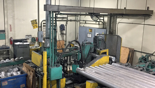

In the upgraded saw, the new motion controller directs a Parker hydraulic cylinder that moves the anvil clamp, pushing it toward the saw blade. After each cut, the clamp releases and the motion controller directs the clamp frame to move back for the next push.

The motion controller gets its instructions from a PLC, which in turn is set up by an HMI screen developed by Catalina Cylinders.“Before the upgrade,” says Marion, “programming the machine with the old controller was a chore. Now, the HMI enables setup in less than one minute.”
