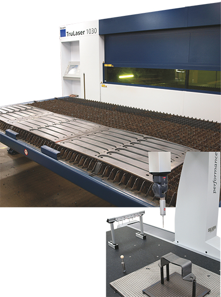

Touring the designated laser-cutting area of the shop, home to the Trumpf cutting-machine duo, we spied a somewhat surprising dynamic—the CO2-laser cutting machine was going to town on 0.060-in.-thick cold-rolled steel, while the fiber-laser machine sliced through thicker 0.312-in. steel plate.
“We often run very thin material (as thin as 0.010-0.015 in.) on the CO2 machine,” shares Wagy, “because we find that the higher gas pressure associated with the fiber machine can blow the small parts out of the blank. We get better process control on these more delicate parts on the CO2 machine.
“Otherwise,” Wagy continues, “for parts 1 to 3 mm thick the fiber machine definitely outperforms the CO2 machine when it comes to speed and productivity. We find that the advantages of the CO2 machine—other than on very delicate parts—come into play for material thicker than 5 mm.”

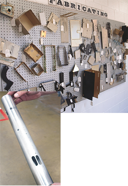

Tella Tool's display of fabricating work
Tella Tool’s display of fabricating work features an array of laser-cut, turret-press punched and press-brake formed parts for customers in the electronics, aerospace, telecommunications and other industries. Cutting the tubular part (left)—which goes into an aircraft fueling system—on its fiber-laser machine required the firm to develop a special cradle fixture.

“We’re always fine-tuning our laser-process parameters to increase speed and improve quality,” Lopez explains. “Often this means modifying the ‘tech tables’ of parameters, including gas pressure and laser power. For example, the parameters programmed into the controller relate to specific types of material and the thickness of the sheet or plate. When we have to cut a material type of workpiece thickness that doesn’t exactly match what’s programmed into the controller, we have to ‘dial-in’ or fine-tune the parameters.”
Asked to cite a recent example, Lopez points to the job running on the CO2 laser during my visit—the 0.060-in. cold-rolled steel sheet.
“At first, we were burning the part edges,” Lopez says. “I increased the gas pressure from 1.5 to 3 bars, and now we’re not only getting cleaner cuts but we’re cutting faster.”
