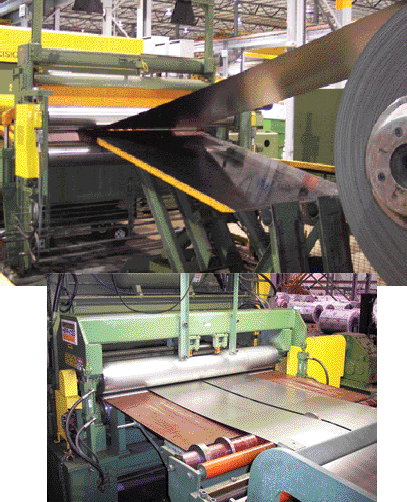

Noting again the need to expand its horizons beyond flat carbon-steel processing for automotive customers, Adamski describes recent growth into titanium-alloy coil processing. “We’re using the tension-leveler line to induce specific changes in the properties of the titanium alloys,” he says. “We can vary the
In 2005 the firm added an electrostatic oiler to the line, to improve its ability to deposit uniform, controlled coatings of oil or prelube on the coil stock. And, it recently switched to a new coating process used to refurbish the line’s bridle rolls, which has extended roll life from 9 to 15 months, translating into fewer outages for maintenance and increased line uptime.
Rounding out its service offerings, Taylor has seen significant growth in work for its multiblanking line, primarily as local metalformers and service centers seek a more modern, accurate and cost-effective to replace their outdated blanking equipment. “We can provide a blanking service that is more cost-effective and that holds tighter dimensional tolerances,” says Adamski, “than the outdated blanking operations that many of the local companies run. We also in many cases can run larger coils and larger lot sizes, improving yield.
“We started the line working 4 hr./ day, 3 days/week,” he continues, “and today that line runs two full shifts a day, five days/week.”

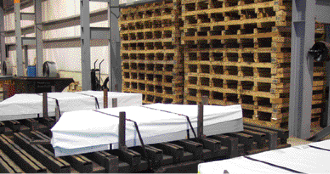

“Packaging offers significant opportunities to control costs throughout the supply chain,” he says. “For example, some local customers, for which we might transport coils only five to 10 miles, in the past would require the coils to be fully paper wrapped, and perhaps elaborately banded. We’ve worked with many customers to show them that, since more coils tend to be used upon receipt, following a JIT schedule, there’s not as much need for full paper wraps. We can more simply band the coils, and then apply a loosely fit paper shroud over the coils rather than a full wrap. Not only is this significantly less expensive on the front end, but it also is simpler and more cost-effective at the back end when the customer has to dispose of the packaging materials.
