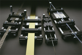

Air feeds may be equipped with accessories and options including anti-buckling guides for limp, delicate materials such as very thin flat or wire stock feeding at high speeds or long progressions. When producing tight-tolerance parts, air feeds can be provided with clamps to release the stock for pilot-pin positioning, bringing increased accuracy. Clamps may be grooved or profiled to feed round or unusual shapes, or padded to protect the material or finish. Also, a multi-stroke control may be employed for long progressions. When shopping for an air feed, consider if the application is right for an air feed—are material thickness and width suitable? And note that the speed range of an air feed may top out at 300 strokes/min. Make sure that the feed manufacturer can provide complementary equipment—reels, straighteners, loop controls, etc.—on a timely basis and can respond rapidly to support requests. And a good supplier should be able to easily modify standard equipment to meet your unique needs.

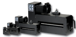

One major benefit of a servo feed is its high production rate—perhaps twice that of an air feed—that translates into rapid return on investment. A servo feed can store many jobs and provides simple job setup. Given some basic information related to strokes/min., feed angle, feed length and pilots, the feed will calculate best acceleration/deceleration and speed. You may override the feed advisor and set these elements, then store them with the job number. The ability to recall a stored job with all of its parameters significantly cuts changeover time, making servo feeds ideal for short runs or frequent job changes.

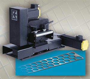

Servo stagger-feed models are designed to aid setup by selecting the best pattern for round or nonround parts. This technique allows the use of irregular-width material with minimum waste, and by pre-programming the optimum pattern, coil-material waste is reduced.

The servo feed is a problem solver in its basic state. Explore its many options for other production solutions, such as special feed-roll coatings or finishes that may be available. Urethane-coated rolls will protect painted, polished or soft material, while a roll provided with a matte or knurled finish offers improved grip. Servo-feed rolls also may be relieved or profiled to handle unusual material shapes with such profiling possibly serving to guide material.
Multiple-strip feed is another benefit of servo units. These feeds can be set up to feed two or more strips with close spacing. Strip 1 feeds through the first feed and is moved by the second feed while strip 2 is moved by the first feed and feeds through the second feed. This arrangement allows equal as well as unequal moves. Feeding multiple strips with a single feed (air or servo) is difficult, however, with gripping sufficient on one strip but not on the other, resulting in inconsistent feed lengths. Servo stagger-feed models are designed to aid setup by selecting the best pattern for round or nonround parts. This technique allows the use of irregular-width material with minimum waste, and by preprogramming the optimum pattern, coil-material waste is reduced. Servo feeds with a gag program allow a pattern of changing feed lengths

One major benefit of a servo feed is its high production rate—perhaps twice that of an air feed—that translates into rapid return on investment. Also, a servo feed can store many jobs and provides simple job setup.

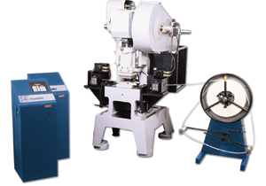

A tandem servo feed, with an entrance and exit servo used to grip and move the material in harmony, offers another solution for feeding thin or flexible material. Electronic gearing between the two feeds maintains light tension on the material. Tandem feeds may be used with coil stock, strip stock, piloted dies and gag dies.

A tandem servo feed, with an entrance and exit servo used to grip and move the material in harmony, is ideal for feeding thin or flexible material. Electronic gearing between the two feeds maintains light tension on the material. Tandem feeds may be used with coil stock, strip stock, piloted dies and gag dies.
