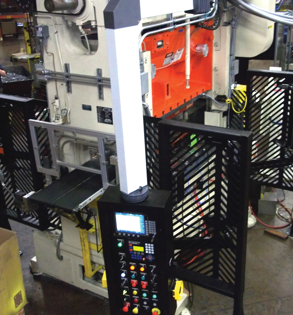

An additional feature of the control that contributes to speedy, accurate changeovers: The ability to input and display plain-language notes on the control. These notes alert the operator to any special setup requirements.

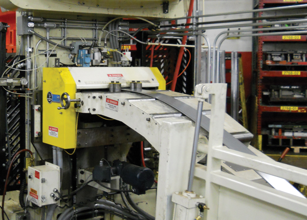

For example, a couple of parts stamped on the line require particularly long feed progressions—20 to 30 in. When this job runs, a note appears on the control panel to reference the unique feed-line program requires, just to warn the operator to check and make sure the proper feed program has been called up by the controller.
Another enabler of mistake-proof set-ups is the controller’s ability to automate pass-line height adjustment of the feed line. The previous feeder was difficult to adjust. As a result, operators tended to use the same pass-line height regardless of the job. That led to several instances of stock buckling and other issues.

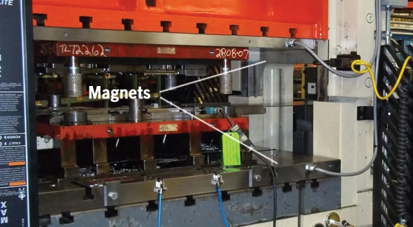

The addition of magnetic die clamping to helping helped trigger a reduction in setup time from 2 hr. to as little as 20 min., resulting in a 30-percent gain in press availability.
Among the OmniLink 5000 control operations selected by the OEM pressroom are 16 output channels for programmable limit switches (PLSs). These provide a variety of press-line commands, including signaling the feed when to begin during the press upstroke, signaling the feed roll to lift near bottom of stroke (to allow strip piloting), and timing of outputs to die-lubricant injectors. The PLSs also ensure that the magnetic die-clamping system releases the tool only when the press is near the bottom of its stroke, for safety reasons.
In addition, the control boasts 16 channels of die protection. Here, operator-programmable inputs monitor a variety of sensors in the tooling as well as those used to monitor the feed line and other auxiliary equipment. End-of-stock sensors and sensors that monitor the scrap system (as previously noted) can prevent hours of downtime and crashes.
Tonnage monitors mounted to the press frame gauge the tonnage being exerted on all four columns of the press, displaying the information numerically and graphically in concert with ram position. Out-of-tolerance tonnage conditions will cause the monitor to stop the press. And, the operator can review tonnage trends to prevent parts with quality issues from getting to customers, and even prevent major tooling and press damage. In some cases, they have made tooling adjustments—staggering punches, for example—to reduce tonnage and/or snapthrough forces.
In addition, the press control’s various inputs and outputs monitor and control everything electrical on the press. If any machine subsystem asserts a fault to stop the press, the control displays a message matching the fault, easing operator troubleshooting. This diagnostic feature allows any fault, such as a low lube level or a safety device detecting an unsafe condition, to be displayed in plain language.  MF
