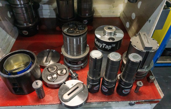

This automated production scheme is maximized at Circa Metals using Mate’s VariBend tooling in its punch presses, where viable, to bend tabs at any angle to 90 deg. and eliminate part moves to a press brake. Likewise, the company uses the EasyTap toolset to produce threaded holes and eliminate secondary drilling and tapping operations. The Multi Tool consolidates smaller tools into a single tool to save space in the turret and allow Circa Metal to load a wider variety of tools in the turret. And, the QCT quick-change tooling saves front-end setup time on new projects.

“On average, we tap 5000 holes/month on various projects,” he says. “There’s no lost time moving the parts to another machine for tapping operations when using the EasyTap tool. Using the quick-change toolless punch-retention mechanism, we’ve reduced setup time by 20 to 50 percent. And, because the tooling is made from M4PM tool steel, we’re enjoying as much as 100-percent better tool-wear resistance and toughness compared to conventional tool steels.”
Regarding the Multi Tool, Schagen reports that the firm loads some 50 Multi Tools in the two turret presses, with two Multi Tool stations in each machine. “This enables us to add more tools in the turret for V-line letter stencils, countersinks and other forming tasks,” he says. “These additional tools in the turret mean more machine indexability and more green-light production time.”
Finally, Schagen comments on the savings realized from using the EasyBend bend-line tooling. Its upper tool has a V-line stencil engraved onto the face of the tool, and the lower tool is a blank die. “As the upper tool penetrates the sheet metal,” he says, “it creates a crisp bend line and makes the material suitable for subsequent bending by hand.”
