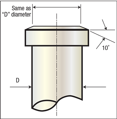

Reducing head diameter by chamfering the contact surface on the head (Fig. 2) will minimize compressive loading and flex at the unsupported outside diameter of the head during initial punch impact. Applying a shear angle to the punch point also will help reduce the forces through the punch body and the punch head.

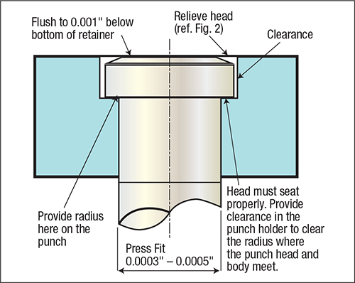

Proper fitup between the punch body and punch holder is essential to prevent punch pumping. Good design and build practices should include these design features (Fig. 3):
• Engineer the body of the punch to have a slight press fit into the retainer—0.0003 to 0.0005 in. should suffice.
• Ensure that the head is fully supported and seated into the counterbored hole in the retainer.
• Ensure that the retainer is cleared for the radius connecting the head to the shank. Provide just enough clearance for the radius; avoid excessive clearance.
• Fit the punch so that the bottom of the head rests as close as possible to the bottom surface of the retainer, but no more than 0.001 in. below.
