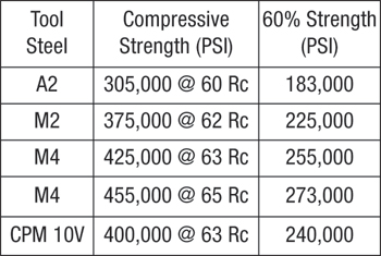

compressive strength data

Punch tip performance is reported to be best when the maximum loads remain below 60 percent of the compressive strength of the punch body material. The table below contains compressive strength data for some common tool steels and heat treatments. To minimize punch-tip breakage problems, the punch tip (Ft) load should be less than the value shown in the 60 percent strength column.
Taking this engineering approach to punch selection eliminates guesswork and maximizes punch-tip strength economically.
