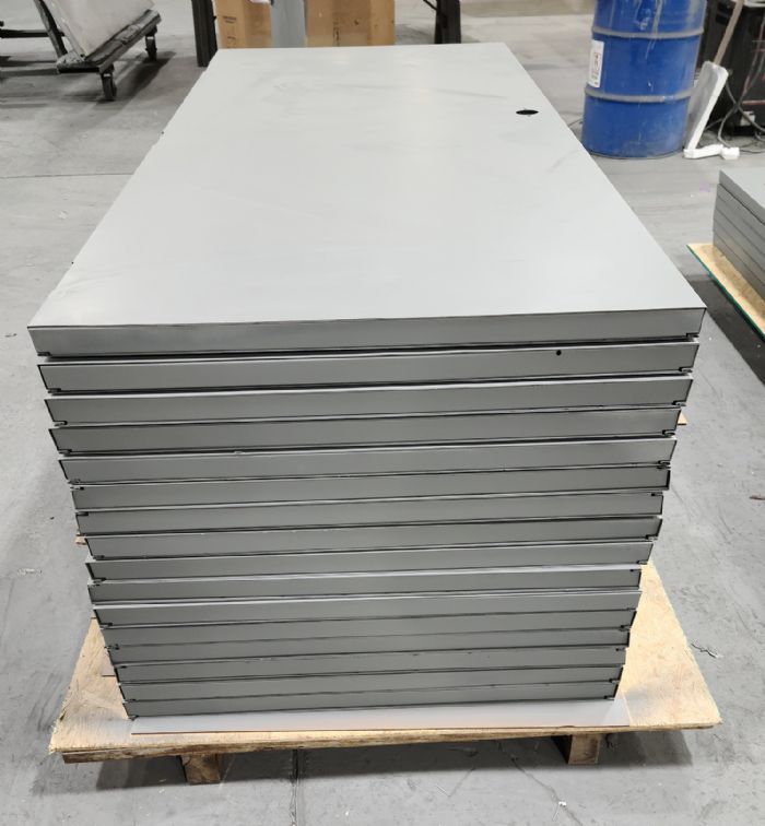

When hollow-metal-door manufacturer Concept Frames sought to minimize—or practically eliminate—scrap from its fabrication process, director of operations Daniel Gibbs knew that there had to be a better solution than nibbling nested parts from sheets on its pair of CNC turret punch presses. Taking in 48-in.-wide blanks from its service center and cutting 12-in.-wide strips using a 3⁄16-in.-wide nibbling tool led to a lot of sheet metal scrap, Gibbs explains, noting that the 12-in. material is used to fabricate the company’s most popular door jambs.

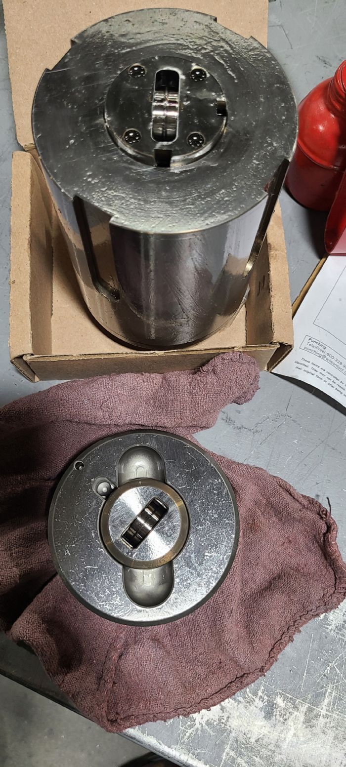

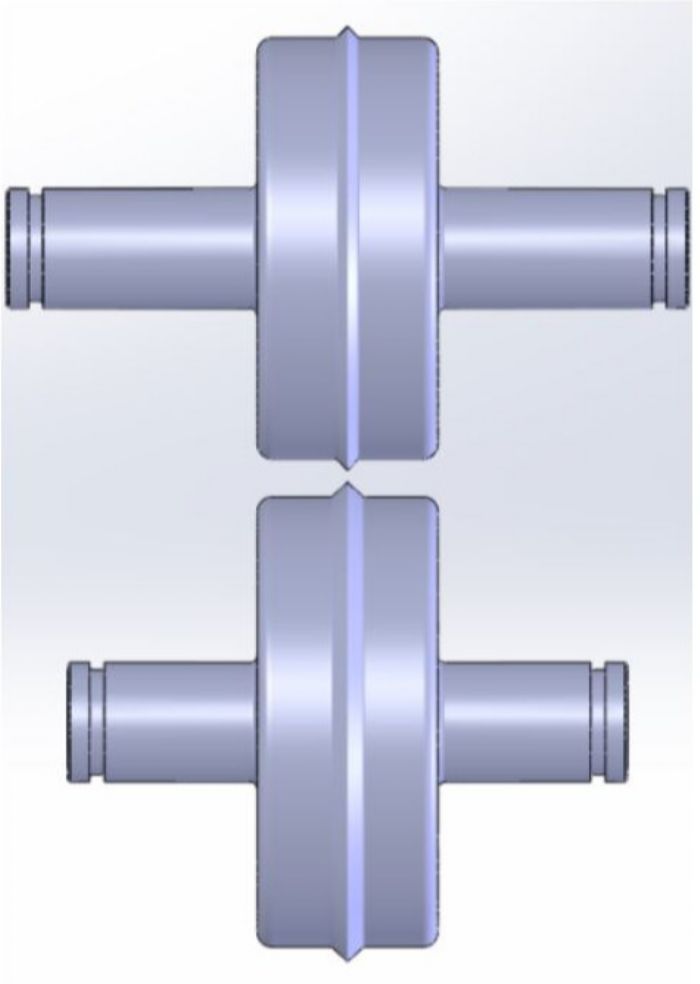

Photo A steel doorsRather than lose 3⁄16 in. of material with every part or leave tabs between part edges to hold the parts in the sheet, Gibbs opted for a specialized punching tool from Wilson Tool: the Rolling Pincher, part of the Wilson Wheel tool family. In use on Concept Frames’ two Murata Motorum 54-punch turret presses, the tool smoothly rolls across the part periphery to create smooth, burr-free perforations. Acting like a scoring knife, the resulting partial shear in the sheet allows operators to quickly snap or shake the parts from the nest. Because the wheels work horizontally across the sheet, rather than vertically as with punching tools, nibble marks and burrs are practically eliminated.
Photo B steel door frames“No scrap, and no skeleton,” Gibbs says. “We can get four 12-in. panels from a 48-in. blank.  We couldn’t do that using nibbling.”

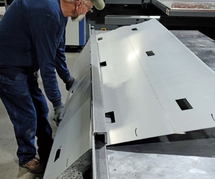

Photo D Rolling Pincher“We fill a lot of custom orders for one or two frames,” Gibbs says. “We’re not trying to compete with the high-volume shops. What we do, we do well, and that’s because we rely on tools like the Rolling Pincher to enable fast processing and manufacturing. After just one or two minutes using the wheel tool—we make two passes over each part edge—plus another minute or so of punching, the operator moves the blank move off to the side and quickly breaks the nest apart. He then sends the parts over to the press brakes for bending.”

Gibbs notes that while the Rolling Pincher wheel tools aren’t inexpensive—”several hundred dollars for a set,” he says—“we’ve perfected a maintenance schedule for the tools to maximize their life. Initially we were going through a set of wheels every three to five days; now we get two to three weeks of production from a set of tools, or longer in some cases. The tooling cost easily is justified by the tens of thousands of dollars we’re saving in material scrap annually.”
How did Gibbs and his team extend the life of the tools? “The tools must be kept clean, and well-oiled,” he says.  “The galvanneal coating on our steel can flake off and build up on the bottom wheel. Every 10 sheets or so our crew uses a pneumatic tool to clean the wheels, and we lubricate the wheels every five to 10 sheets. The process takes just 2 min., and dramatically extends tool life.”
Photo E braking parts from sheetOther than the wheel tool, Gibbs notes other tooling, provided by Wilson Tool, that supports its production. For example, the doors receive cylindrical locks that requires punching a 2.25-in.-dia. round hole with a notch on each side. “To punch that shape,” Gibbs explains, “we buy a special tool to attain that profile in one hit. Another commonly used tool is a 4 by 1.75-in. rectangular tool for punching the hinge slot—we have to punch with this tool twice to cut a slot to accept a 5- or 6-in. hinge. MF
