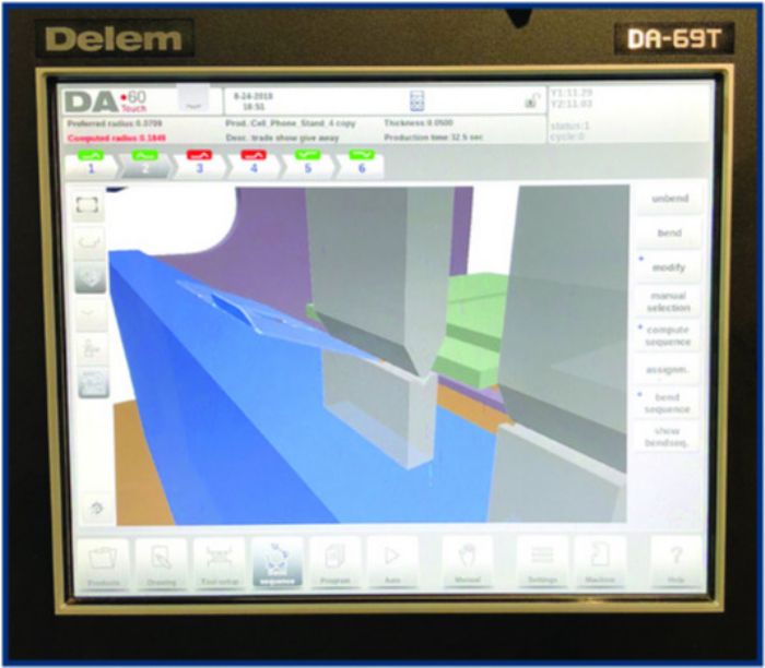

Setup represents a huge improvement over the old press brake, according to Banks. For example, before, operators set bending degrees manually, and had to reset as the angles wandered.
“Manual setting would take 5 to 10 min. of tinkering prior to starting to bend parts,” he says. “With the new Blaise, we were able to build a complete library in the system as we bent parts. Now we simply find the part number, the controller brings it up, and we are ready to start bending with all tooling and the backgauge set. We just load the material to the backgauge and step on the pedal. So far we have not had any discrepancies in bends…it's been right every time.”
Overall, that’s a huge time saver for SC Products.
“When bending 20 parts during a run, we may have spent 45 min. to an hour on setup,” says Banks. “Now it’s a matter of minutes.”

Another new-machine feature appreciated by Banks and the SC Products team: a control screen displaying parts and bends.
“We push a button to bring up an image on the screen, which really helps out the newer operators who may not be as familiar with a part,” he says. “They can see what the part and its bends look like, and we can add notes to the screen with specific bending instructions.”
The above-mentioned features not only have reduced mistakes but, estimates Banks, cut press brake time in half for most jobs, which brought schedule flexibility and added capacity for new work.
