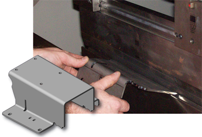

“When I was still with Trumpf, this customer was looking to improve its fabrication capabilities,” he says. “One of my jobs at the time was to take a customer’s part, apply it to the equipment, and show the customer how we would make the part. I noticed two engineers from the customer fitting parts together to make an assembly. I looked at the parts and told them the three-piece assembly could instead be made as a single piece. When they were at lunch I went into my 3D modeling software, placed the parts together as a single piece, unfolded it and went out to a laser-cutting machine and made the new one-piece part. They were amazed.”
Lockwood has brought that penchant for simplifying part design and removing unnecessary manufacturing steps to Fabricating Solutions, in one case reducing the number of press-brake programs needed to create different types of door parts from 140—one for each part—to three.
“We had a Trumpf V130 press brake with standard tooling, and were programming it each day for about 140 head-hinge and strike-jamb parts,” recalls Mike Kolovich, engineering manager at Amweld Building Products, Stow, OH, noting that the programs weren’t being stored in the press brake. “We asked Fabricating Solutions to program all of those parts into the brake so that our operator would spend his time making parts instead of constantly programming for each job. Dewey Lockwood looked at the part profile drawings and designed some tooling for us that would let us make all these parts using only three programs. Now, instead of constant programming and constant tool changeovers, we use one set of tooling and three different programs depending on the part profile. This has increased our efficiencies so that instead of producing 50 parts/day we are making 250.”
